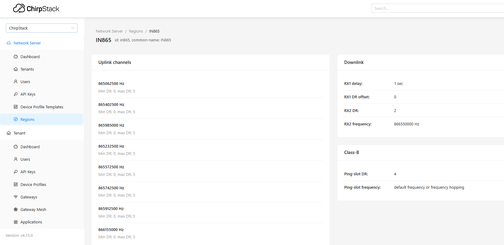

ADR is default Enable in ChirpStack configuration files, I didn't change anything except add extra channels of IN865.

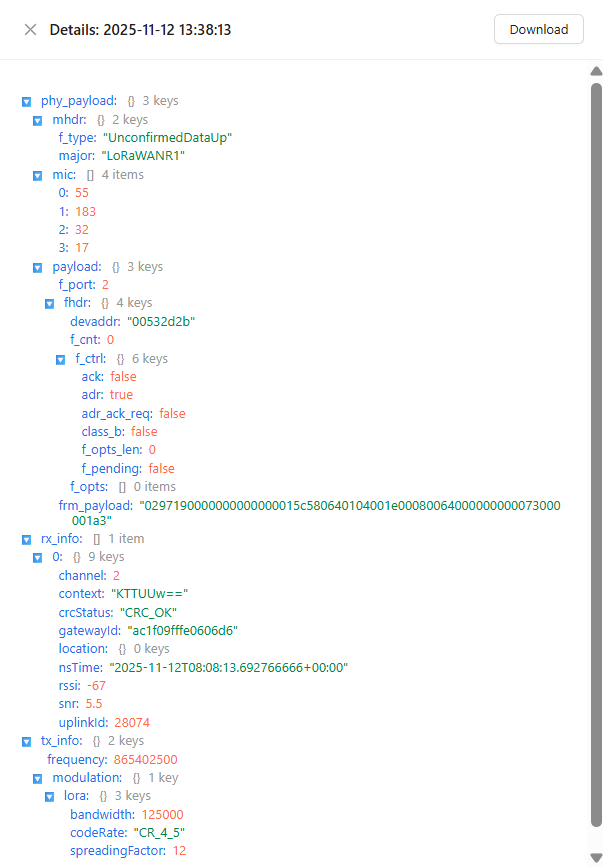

Below is screenshot of last uplink received from device on Chirpstack V4 showing adr true and SNR : 5.5

ChirpStack sending LinkADRReq mac-commands to change the device data-rate depends on a couple of things:
  • If ADR is disabled in the ChirpStack configuration files (default it is enabled).
  • Which ADR algorithm has been selected in the device-profile (you mentioned that it is set to the default)
  • If the uplink contains an adr: true flag.
  • The current data-rate of the uplinks and the reported SNR value.
Could you please verify the last to bullets? Ideally by providing a screenshot of the last uplink showing the adr flag value + the reported SNR values by the receiving gateway(s).
