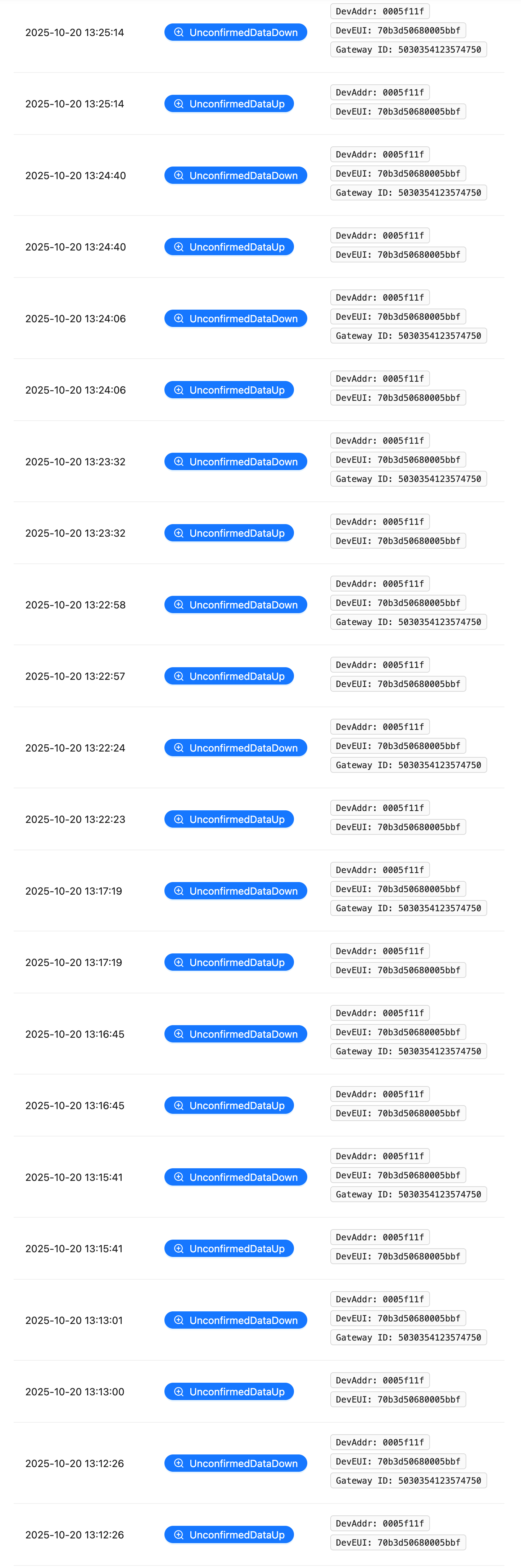

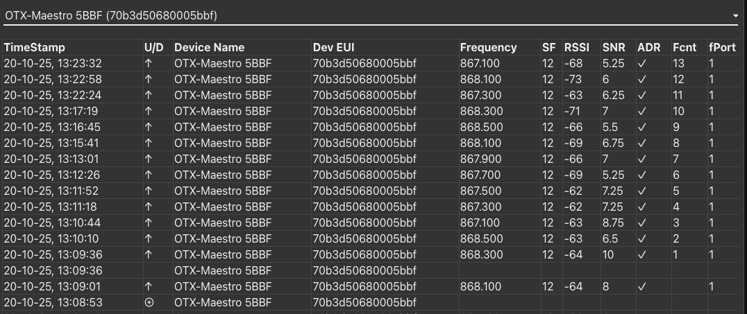

Chirpstack keeps on sending NewChannelReq, even after NewChannelAns OK
3
Viewed 148
Chirpstack keeps on sending NewChannelReq, even after NewChannelAns DR + Channel OK. End device has also implemented the new frequencies. LinkADRReq never sent, device keeps sending at DR0/SF12

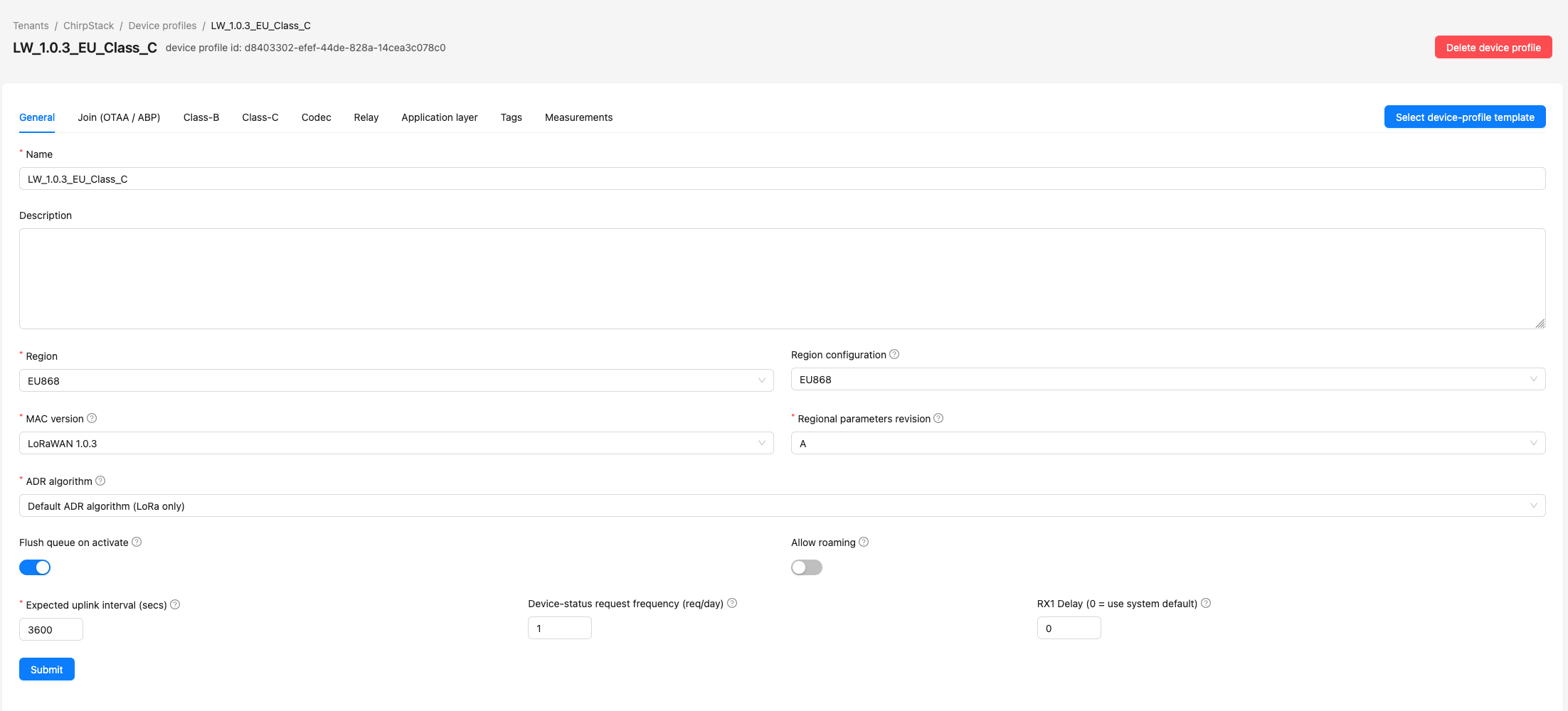

Chirpstack v4.13.0
Device: OTX-18, custom LoRaWAN stack V0001.D312
LoRaWAN MAC Version: 1.0.3 / Class C

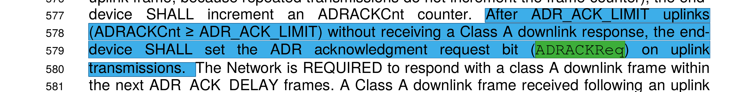

The issue is the adr_ack_req: true. If that is set to true, ChirpStack will reset back to the default channels and will re-negotiate the custom channels or channel-mask.
If there is a regular downlink, then normally the ADRACKReq bit should not be set, see also:
Note that ADR_ACK_LIMIT is set to 64. Thus only after 64 uplinks without receiving a downlink, it is expected to be set.
