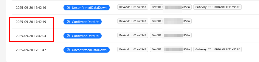

I am seeing retransmissions from nodes and achlowledgement downlink only seen at latest uplink. So, I assume node is not receiving achnowledgemt and retransmitting same frame. I also noticed that such retransmissions happen only where gateway is using mqtt. Gateway with UDP forwarder are fine.
imageimage869×211 14.2 KB

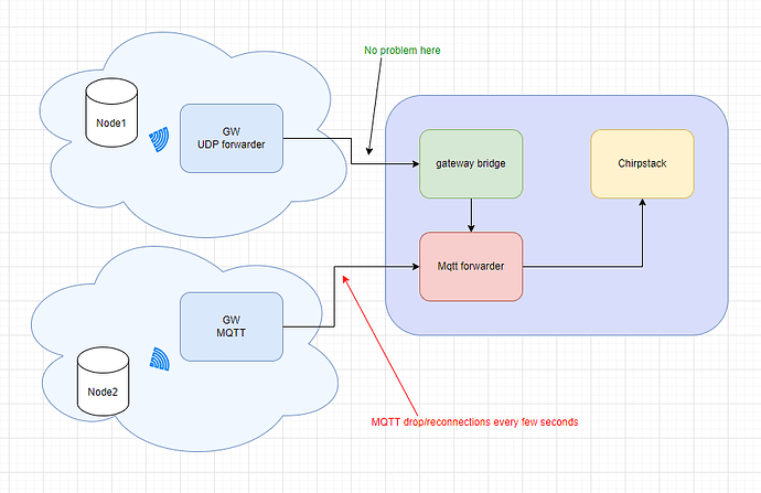

imageimage889×577 41 KB
When I checked mosquitto logs on server side I see GW is trying to open new connection (same IP but different port) every 2-3 seconds, so mqtt is dropping previous connection and opening new one. it is most probably due to this reconnections that some downlinks are lost.
