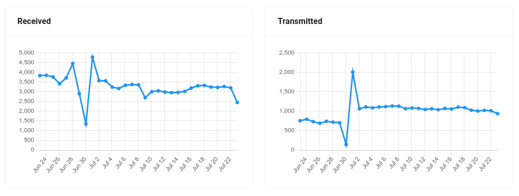

I have a self-hosted chirpstak (4.6.0). When I log in and go to the dashboard of a gateway, I can see these kind of stats
I'd like to intergrate those values in my platform, but I don't know which is the best/recommended way to do so.
