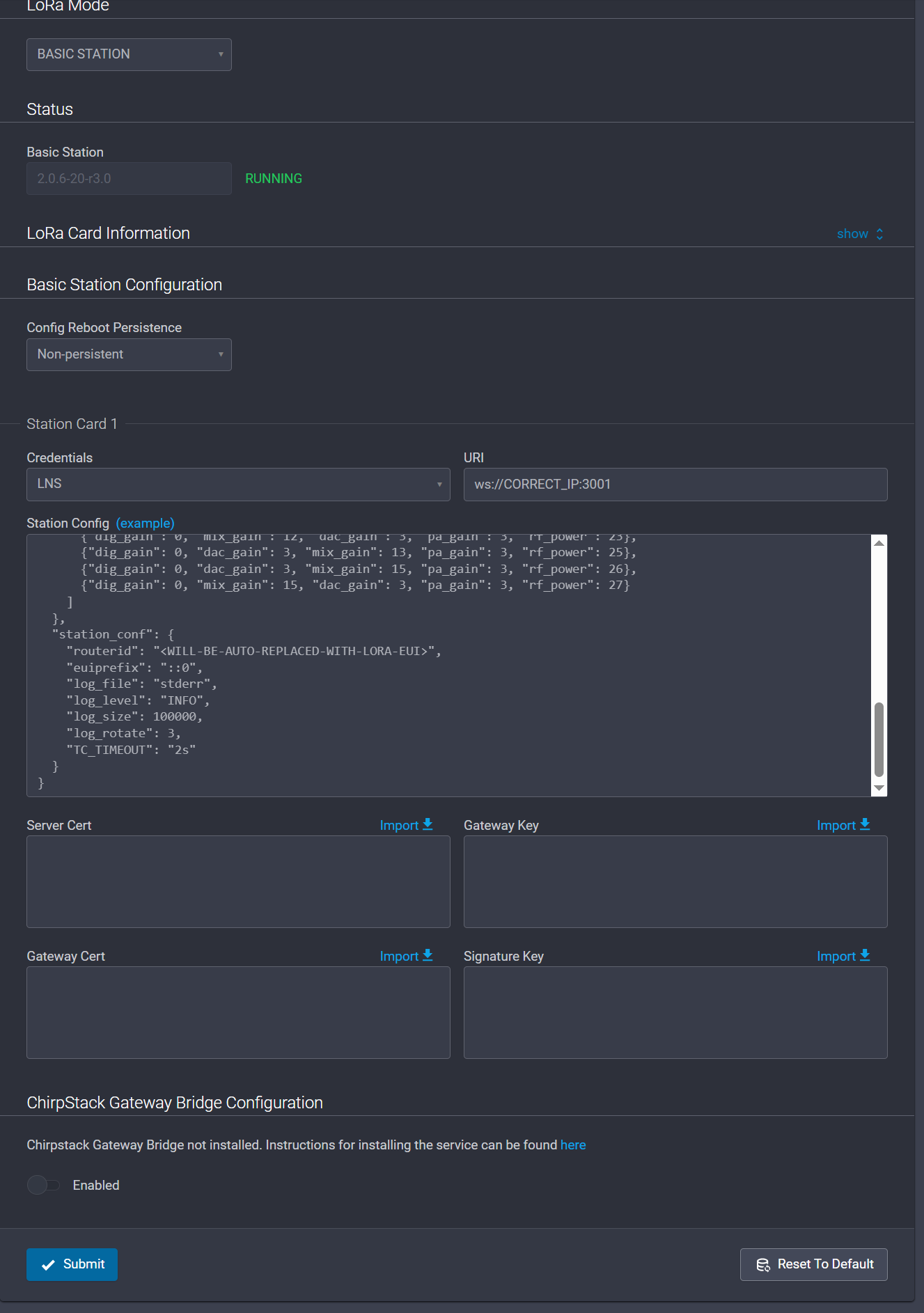

I'm trying to connect a MultiTech MTCDT GW running in Basic Station mode to a Chirpstack-Gateway-Bridge, running on a Debian machine. For testing I'm running without certificates at all, and thus want to connect via ws://.
However, I get an error when trying to run the Basic Station, as it complains about the "routerid" being set to an illegal EUI. It seems to stem from the "routerid": "" line not being overwritten during startup. Any ideas what might be happening here, or what next steps I can do to troubleshoot? I'm attaching the chirpstack-gateway-bridge.toml and the station.conf from the gateway.
Gateway setup:

station.conf (from GW):
  "SX1301_conf": {
    "lorawan_public": false,
    "clksrc": 0,
    "pps": true,
    "device": "/dev/spidev0.0",
    "chan_FSK": {"bandwidth": 125000, "datarate": 50000, "enable": true, "if": 300000, "radio": 0},
    "chan_Lora_std": {"bandwidth": 250000, "enable": true, "if": -200000, "radio": 0, "spread_factor": 7},
    "chan_multiSF_0": {"enable": true, "if": -400000, "radio": 0},
    "chan_multiSF_1": {"enable": true, "if": -200000, "radio": 0},
    "chan_multiSF_2": {"enable": true, "if": 0, "radio": 0},
    "chan_multiSF_3": {"enable": true, "if": -400000, "radio": 1},
    "chan_multiSF_4": {"enable": true, "if": -200000, "radio": 1},
    "chan_multiSF_5": {"enable": true, "if": 0, "radio": 1},
    "chan_multiSF_6": {"enable": true, "if": 200000, "radio": 1},
    "chan_multiSF_7": {"enable": true, "if": 400000, "radio": 1},
    "radio_0": {"enable": true, "freq": 868500000, "rssi_offset": -162, "tx_enable": true, "type": "SX1257"},
    "radio_1": {"enable": true, "freq": 868500000, "rssi_offset": -162, "tx_enable": false, "type": "SX1257"},
    "tx_gain_lut": [
      {"dig_gain": 0, "mix_gain": 11, "pa_gain": 0, "dac_gain": 3, "rf_power": -6},
      {"dig_gain": 0, "mix_gain": 13, "pa_gain": 0, "dac_gain": 3, "rf_power": -3},
      {"dig_gain": 0, "mix_gain": 9, "pa_gain": 1, "dac_gain": 3, "rf_power": 0},
      {"dig_gain": 0, "mix_gain": 10, "pa_gain": 1, "dac_gain": 3, "rf_power": 3},
      {"dig_gain": 0, "mix_gain": 12, "pa_gain": 1, "dac_gain": 3, "rf_power": 6},
      {"dig_gain": 0, "mix_gain": 10, "pa_gain": 2, "dac_gain": 3, "rf_power": 10},
      {"dig_gain": 0, "mix_gain": 11, "pa_gain": 2, "dac_gain": 3, "rf_power": 11},
      {"dig_gain": 0, "mix_gain": 11, "pa_gain": 2, "dac_gain": 3, "rf_power": 12},
      {"dig_gain": 2, "mix_gain": 12, "pa_gain": 2, "dac_gain": 3, "rf_power": 13},
      {"dig_gain": 0, "mix_gain": 13, "pa_gain": 2, "dac_gain": 3, "rf_power": 14},
      {"dig_gain": 0, "mix_gain": 15, "dac_gain": 3, "pa_gain": 2, "rf_power": 16},
      {"dig_gain": 0, "mix_gain": 10, "pa_gain": 3, "dac_gain": 3, "rf_power": 20},
      {"dig_gain": 0, "mix_gain": 12, "dac_gain": 3, "pa_gain": 3, "rf_power": 23},
      {"dig_gain": 0, "dac_gain": 3, "mix_gain": 13, "pa_gain": 3, "rf_power": 25},
      {"dig_gain": 0, "dac_gain": 3, "mix_gain": 15, "pa_gain": 3, "rf_power": 26},
      {"dig_gain": 0, "mix_gain": 15, "dac_gain": 3, "pa_gain": 3, "rf_power": 27}
  "station_conf": {
    "routerid": "<WILL-BE-AUTO-REPLACED-WITH-LORA-EUI>",
    "euiprefix": "::0",
    "log_file": "stderr",
    "log_level": "INFO",
    "log_size": 100000,
    "log_rotate": 3,
    "TC_TIMEOUT": "2s"
