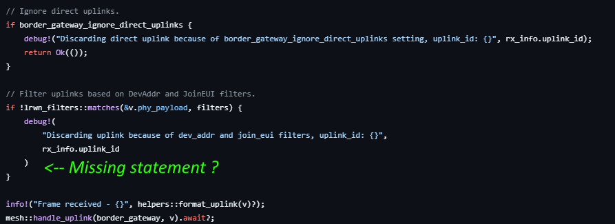

I. Gateway-mesh filter problem
However, there seems to be an issue with their functionality. I noticed that even when configuring a filter, all packets continue to pass through without distinction.
Inspecting the source code, specifically the backend.rs (https://github.com/chirpstack/chirpstack-gateway-mesh/blob/master/src/backend.rs#L306) file at line 307, it seems that a return Ok(()); statement is missing after applying the filter. This could explain why the filtering isn't effective. Has anyone else encountered this issue?
