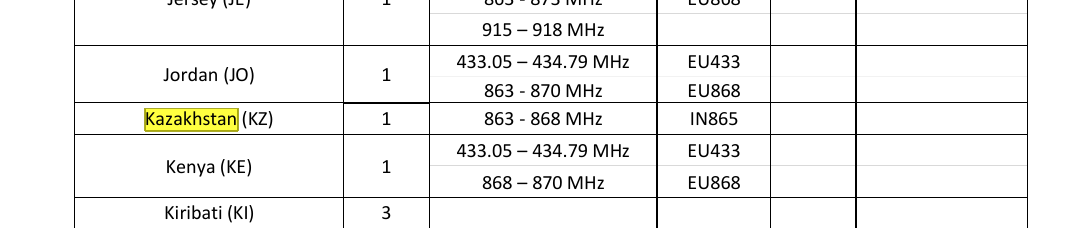

According to the RP002 specs, you should be able to use the IN865 region config however:
