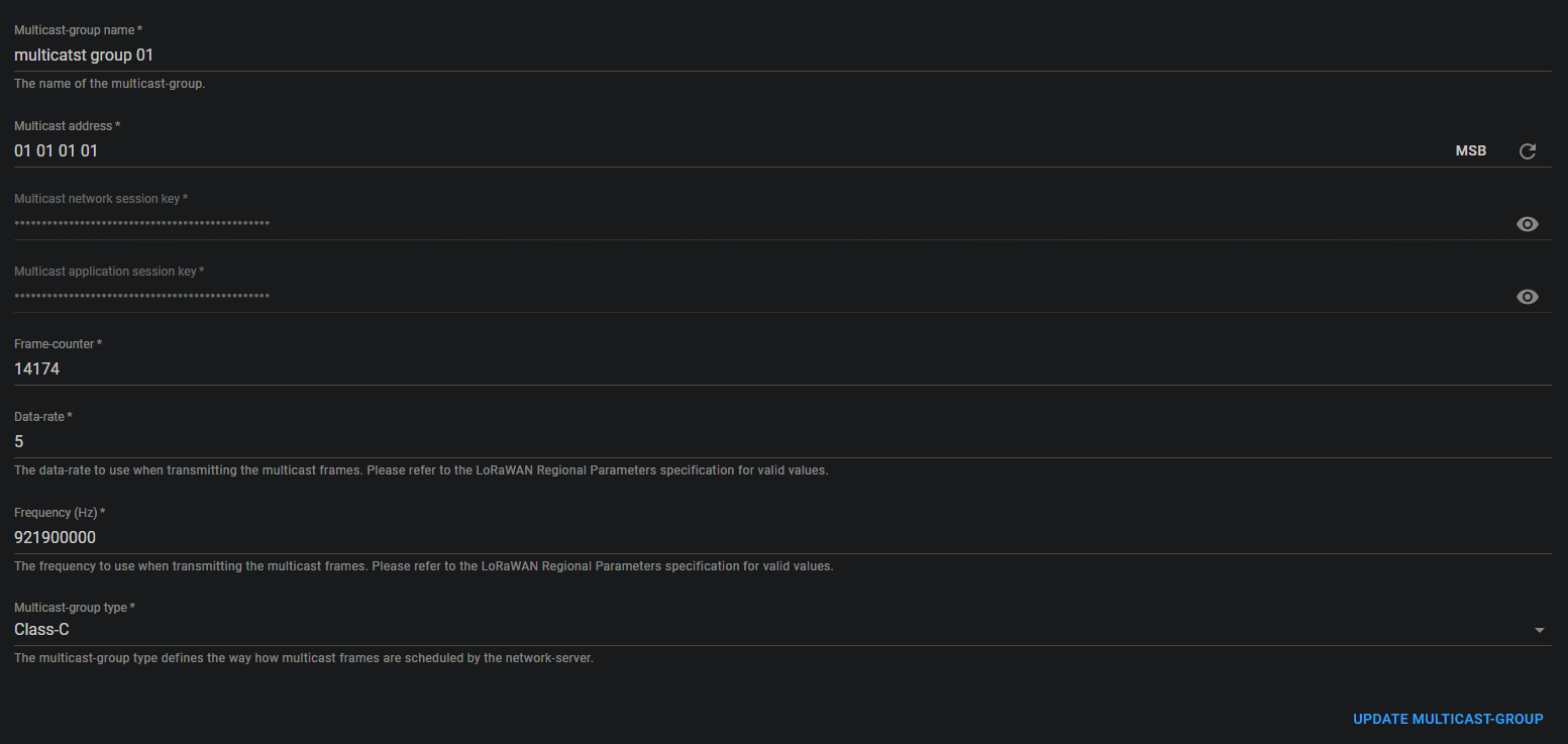

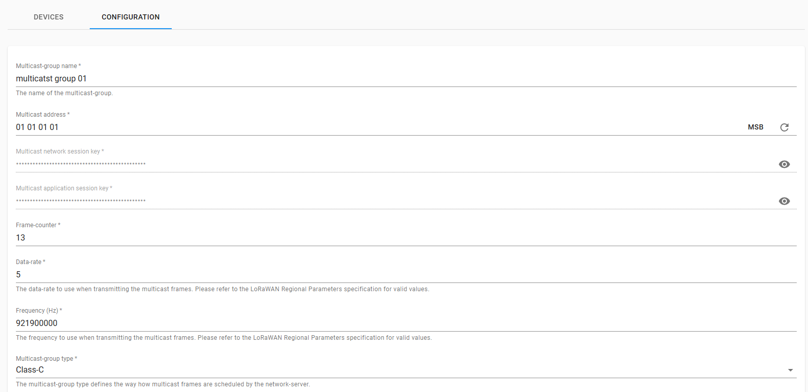

I moved the server a few days ago, and I wanted the multicast functionality to work the same as before, so I set the Multicast Group configuration to the same as before on the server moved.
multicast group configuration(before)
multicast group configuration(after)
Multicast Address, Network session key and Multicast Application session key is same.

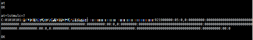

  4. The RAK3172 module registered the multicast setting and waited for reception as follows.

The module's multicast downlink reception was working fine, but then suddenly stopped, and it no longer receives multicasts. Unicast reception works. If set again the multicast configuration on the chirpstack server and join the module again, the reception resumes, but the module will not receive multicast messages shortly afterwards. If the problem is that the configuration is wrong, I think I would have failed the first time received it.
Strangely, the module is receiving multicast transmissions normally from the gateway bridge connected to the previous chirpstack server. If Multicast Address and McAppsKey and McNwksKey are the same between two servers, why can one server multicast transmissions work nomally, and the other has problems?
Any help is appreciated.
Please note that the before frame-counter is higher than the frame-counter after. The device will not accept (multicast) downlink with frame-counter values that have not incremented compared to the previous (valid) downlinks.
@Orne Brocaar
Followed advice, adjusted the frame counter to its previous settings, and tested multicast again, and it works fine. Thank you!
