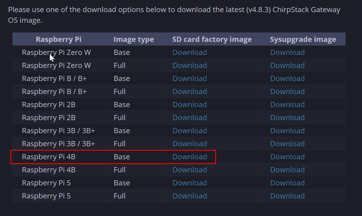

I am planning to add USB modem support for Gateway OS.
Currently I am using RPI 4B image
But I do not see it in the Github list, there is no BCM2711 listed.
Could someone advice where to find it?
Thanks

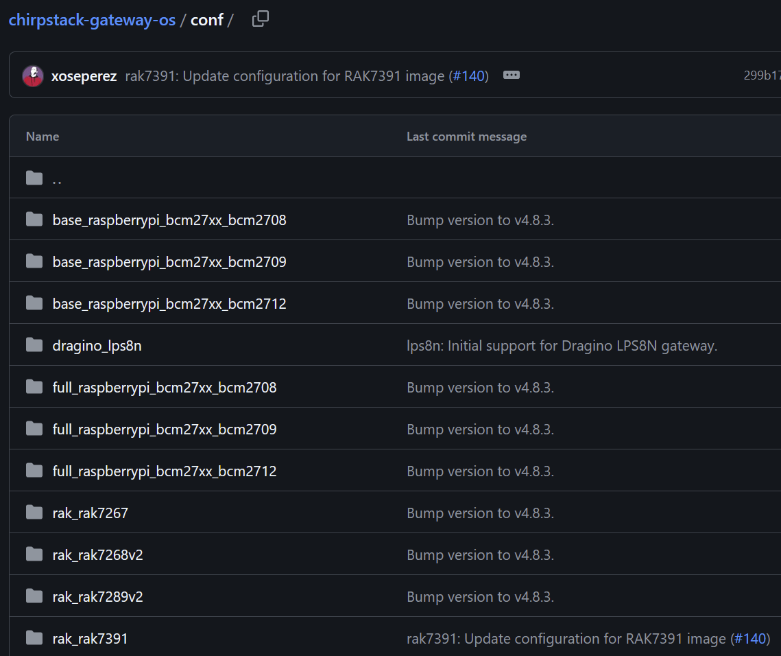

Raspberry Pi 2/3/4 all use the same configuration. You will find it in the _bcm2709 directories (full- includes ChirpStack + Node-RED, base- is just the packages needed to run the RPi as a LoRa gateway).
You need to custom build the chirpstack gateway os image by enabling USB Drivers
