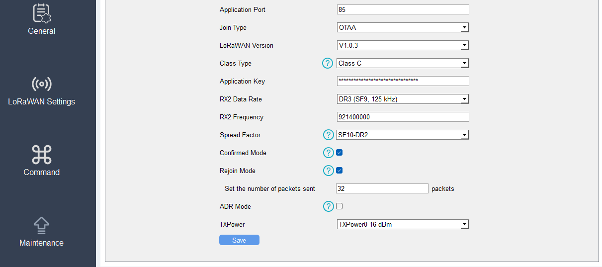

Device UC100 is use class C. I'm have build a web to design a control interface to switch 8 relay ports on/off using the downlink protocol is gRPC.
I tried changing the 'RX2 Frequency' on the UC100 from 'DR2 SF10' to 'DR3 SF9' and adjusted the uplink to shorten the transmission time in the 'Spread Factor' section to 'SF9-DR3', while also turning off ADR on both the device and in the server configuration, but I still couldn't optimize that part; the command was still being missed.
In my prediction, because 8 ports are enabled simultaneously, it sends 8 commands at once, which causes the Chirpstack queue to be full, right? Can you give me a way to fix this issue?
