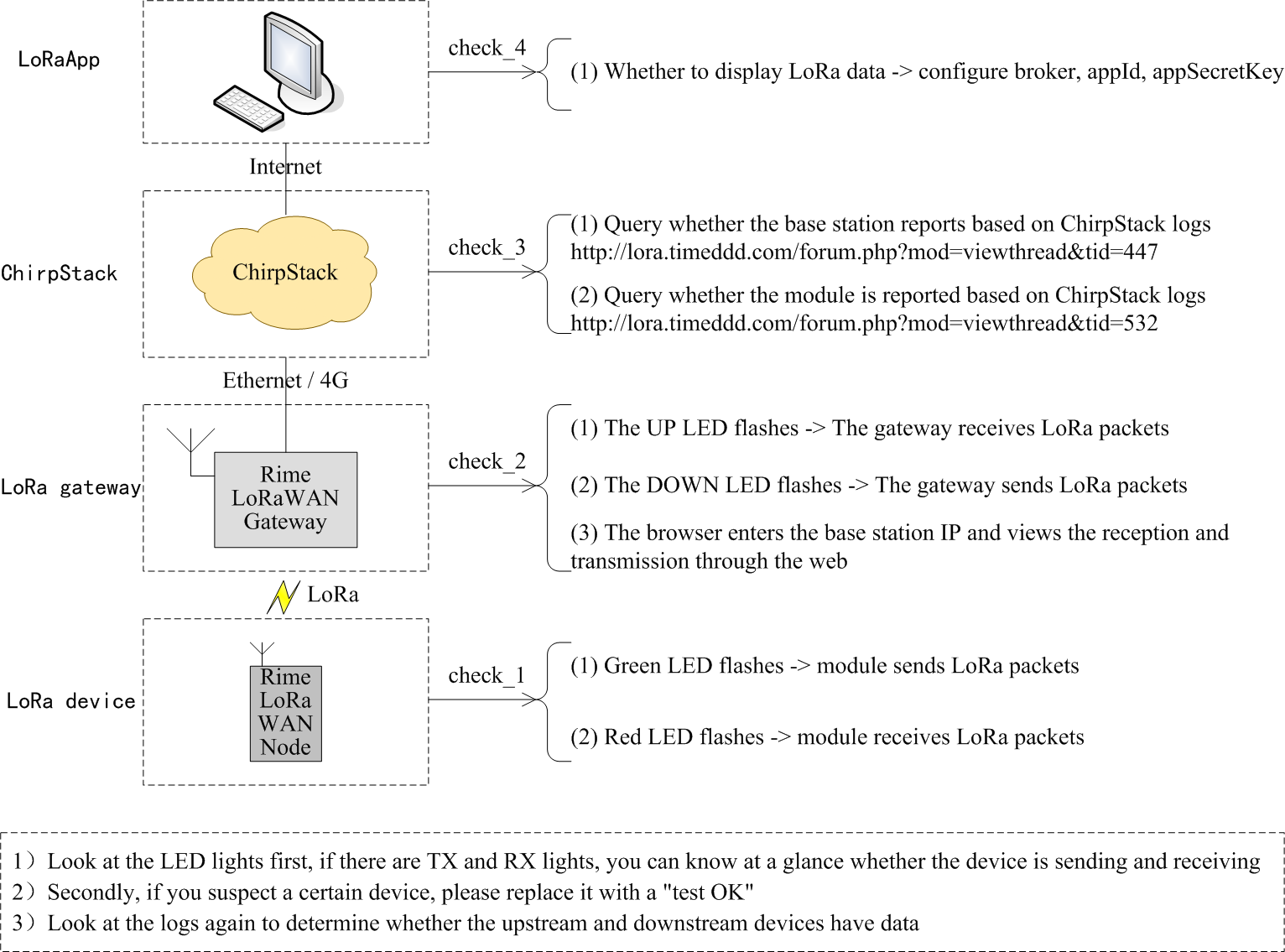

As shown in the figure above, if possible, check the gateway logs or LED lights to see whether the Join Accept LoRa radio message was correctly sent.
