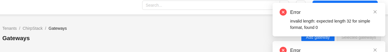

today i managed to backup and restore my chirpstack docker environment.
After testing i saw an error, which i can not identify - i dont know even, if this does impact anything by the way.
Tenant -> Gateways -> Overview page
Error message: "Error invalid length: expected length 32 for simple format, found 0"
Any ideas?
thx
Various columns are stored in the database in a specific (binary) format in the database and are on read from the database decoded. It looks like during the restore one (or more) of these columns or one (or more) of these records were not restored properly.
@Brocaar -> thx for your information
okay -> i had missed the SAVE in Backup process.
