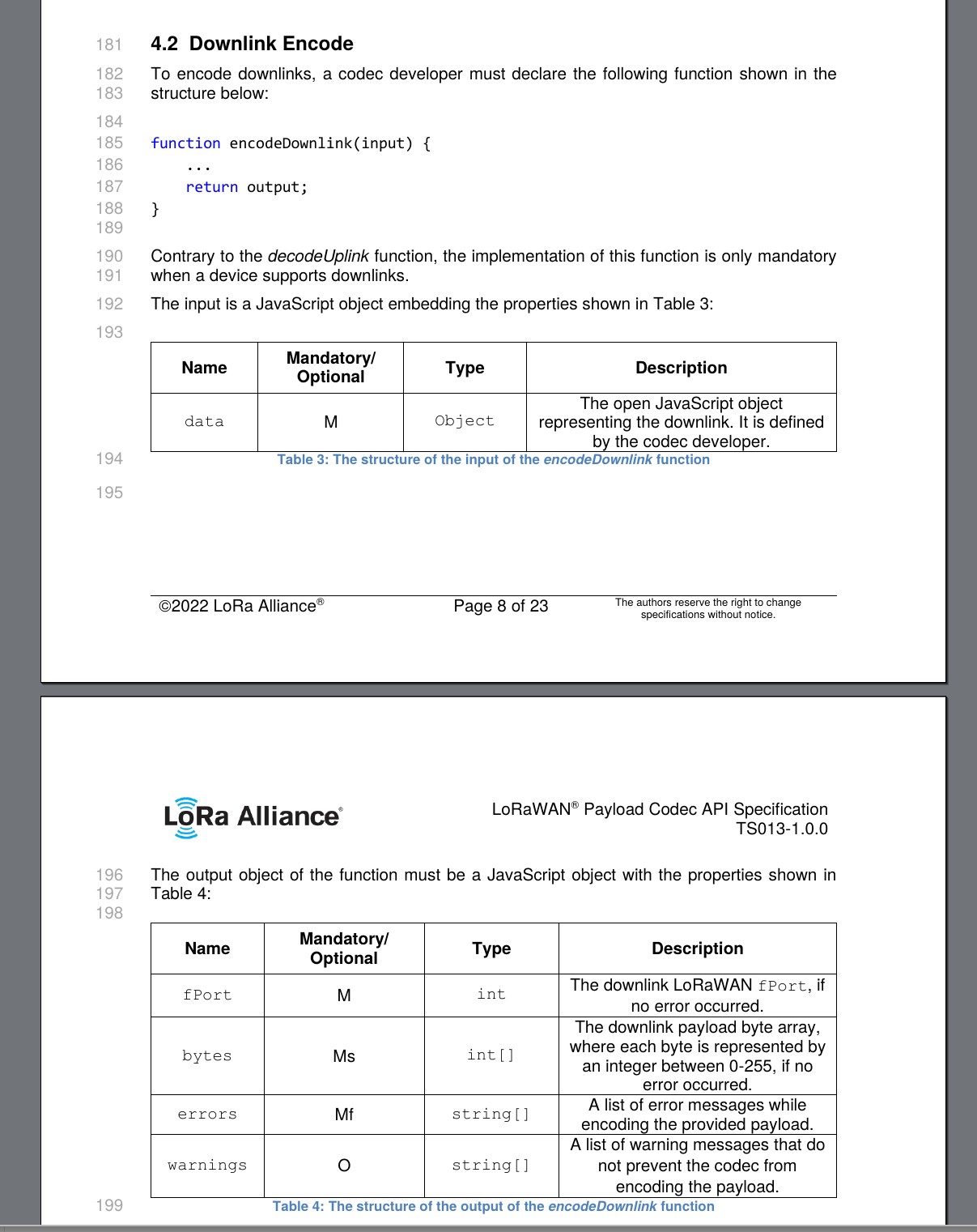

EDIT: ignore my previous answer, this is about the encode part. Please refer to the Payload Codec API specification:
Before ChirpStack v4.14.1, ChirpStack was (incorrectly) taking the given fPort, however, it should be returned by the encodeDownlink function based on the provided input. I think this is the difference you are seeing.
