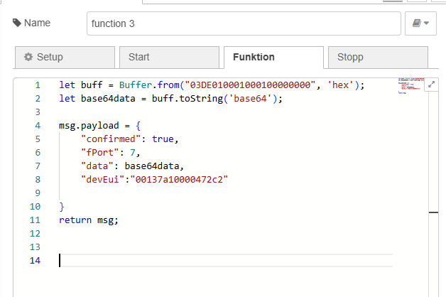

let buff = Buffer.from("03DE010001000100000000", 'hex');
let base64data = buff.toString('base64');
Node-Red
msg.payload = {
"confirmed": true,
"fPort": 7,
"data": base64data,
"devEui":"00137a10000472c2"
return msg;
This question does not contain enough information to answer it. E.g. it shows how you construct the msg, but it does not show how you try to enqueue it. I assume you are using ChirpStack v4?

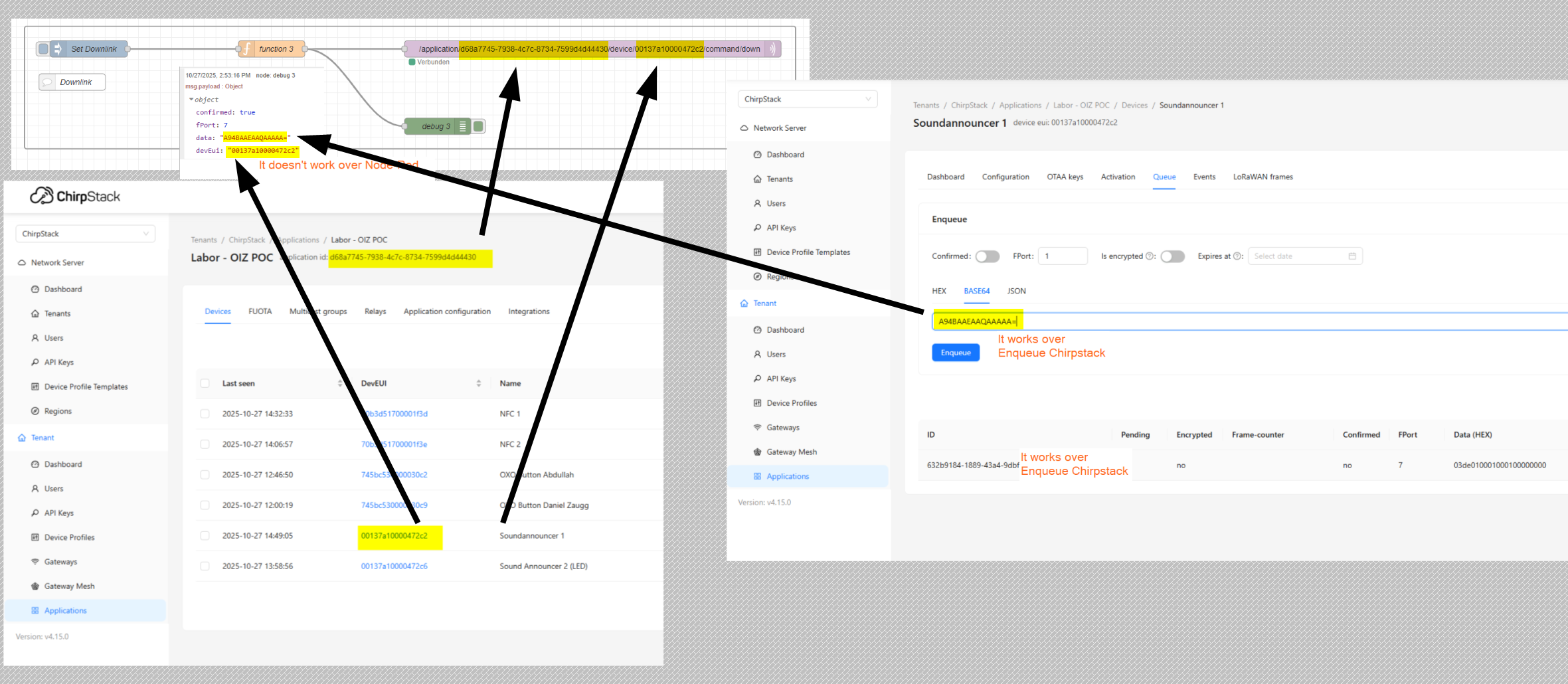

The downlink over enqueue over ChirpStack v4 it works.
But it doesn't work over Node-Red and this my problem, which i have to solve it.
Problem was solved by removing leading dash from the mqtt path.
"application/..." instead of "/application/..."
