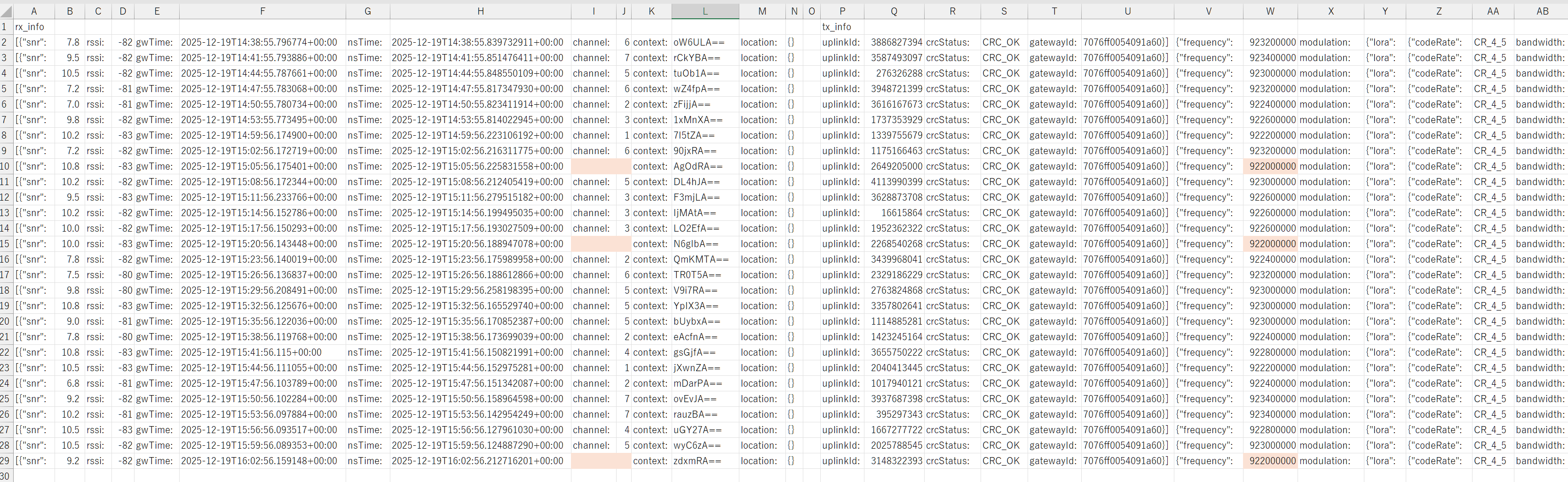

I used Postgres Integration and found that when I looked at rx_info, there was no channel data.
Using Postgres Integration, I observed that channel data is missing when viewing rx_info.
I am using AS923.
At 922MHz, the channel should be 0, but no data exists.
For all other frequencies, channels 1 through 7 output correctly.
I am using ChirpStack ver 4.15.
This is not a bug but is caused by the way how the internal Protobuf messages are encoded to JSON. All of the default values are ignored, meaning 0 (int), false (boolean), "" (string) etc... That is why you do not see channel: 0.
Thank you for your response. If it's not a bug, it means I'll need to handle it myself. In the case of null, I'll treat it as 0.
