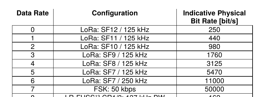

Please note that the default ADR algorithm does not use DR6 and DR7:
Please note that the SX130X concentrator module only supports a single channel for these data-rates, as DR6 uses a different bandwidth and DR7 uses a different modulation (FSK). You can use these data-rates, but it would force the device to use a single channel.
Is this a limitation imposed by ChipStack? Or is there an official limitation (e.g. from the LoRaWAN Alliance) for this?
If the default ADR algorithm does not support DR6 and DR7, I thought I could enable them by editing the region_eu868.toml file.
The gateway channel is already configured there:

In my opinion, limiting to one channel is acceptable in some applications. Increasing the data rate to DR7 compared to DR5 reduces time on air by a factor of 10. This saves energy and helps to comply with duty cycle restrictions.
