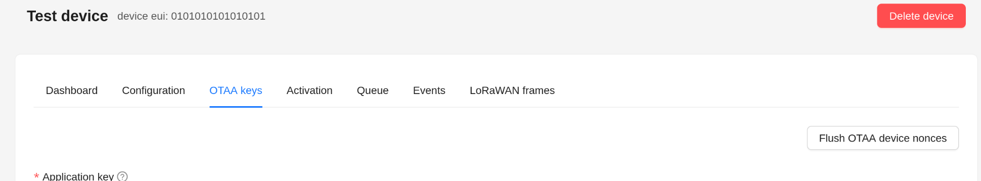

You can do this through the web-interface (under OTAA keys -> Flish OTAA device nonces button):
I do it also via api.

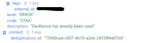

I tried to delete the devNonce with the button Flush OTAA device nonces but I still have the problem.
Is there another way to remove them?
