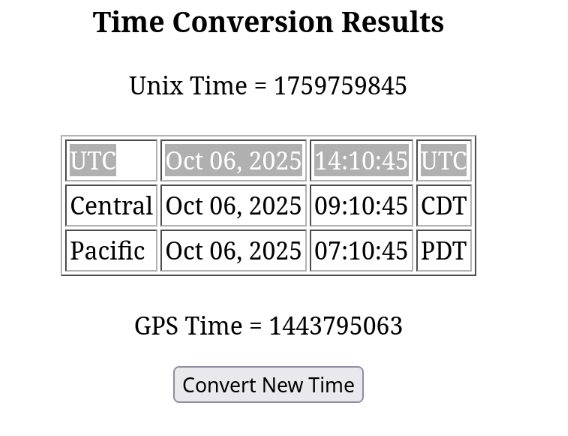

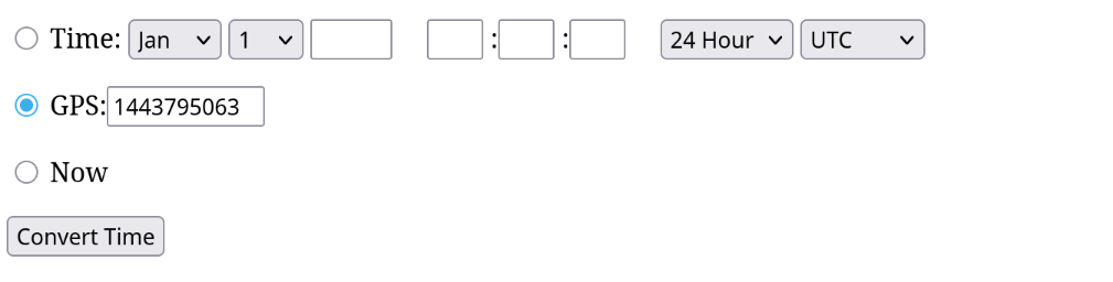

Looking at the timestamp in your log Oct 6 14:10:44 (I assume it is UTC), and the GPS epoch timestamp ("tmms": 1443795063390), I do not see any issue directly.
Note that tmms is in miliseconds (https://github.com/Lora-net/packet_forwarder/blob/master/PROTOCOL.TXT#L134). Converted to seconds, 1443795063.39. If we enter 1443795063 in https://www.andrews.edu/~tzs/timeconv/timeconvert.php, we get Oct 06, 2025 14:10:45 UTC, which is 1 second in the future:
Please note that one of my clients reported in the past that they saw an incorrect tmms reporting by the gateway in the uplinks. If I remember correctly, it was reported in nanoseconds and not milliseconds as specified by the PROTOCOL.txt document. This might as well be related.
