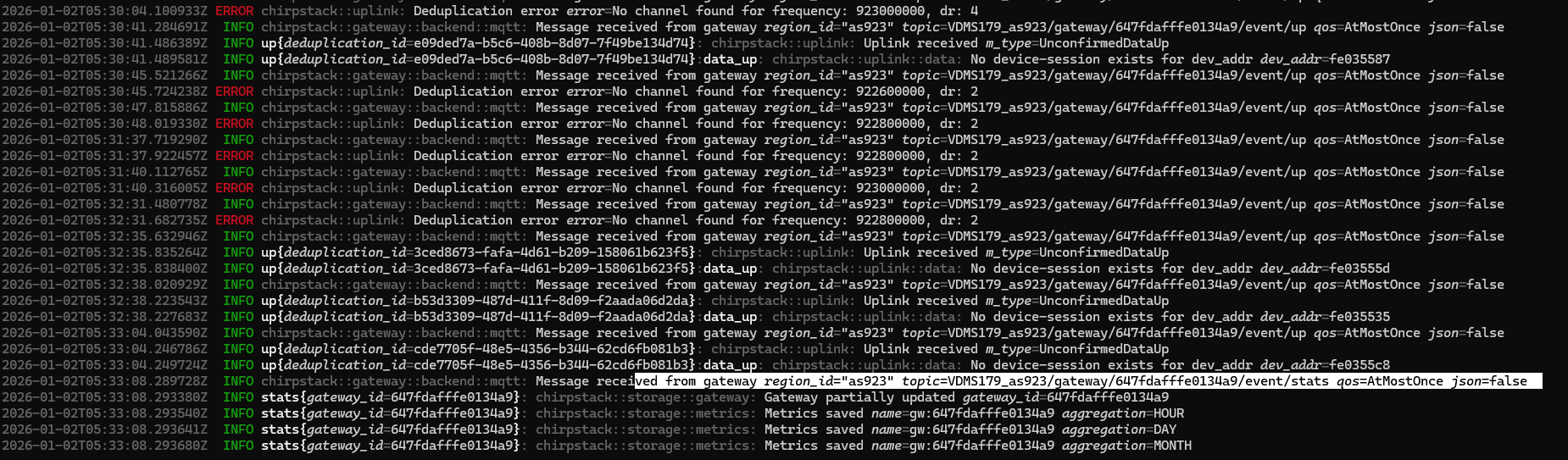

Hey @brocaar, thanks for your reply.
Both gateways are configured with the same topic_prefix because they operate in the same region (AS923_1). Is using the same topic_prefix for both gateways a potential issue?
