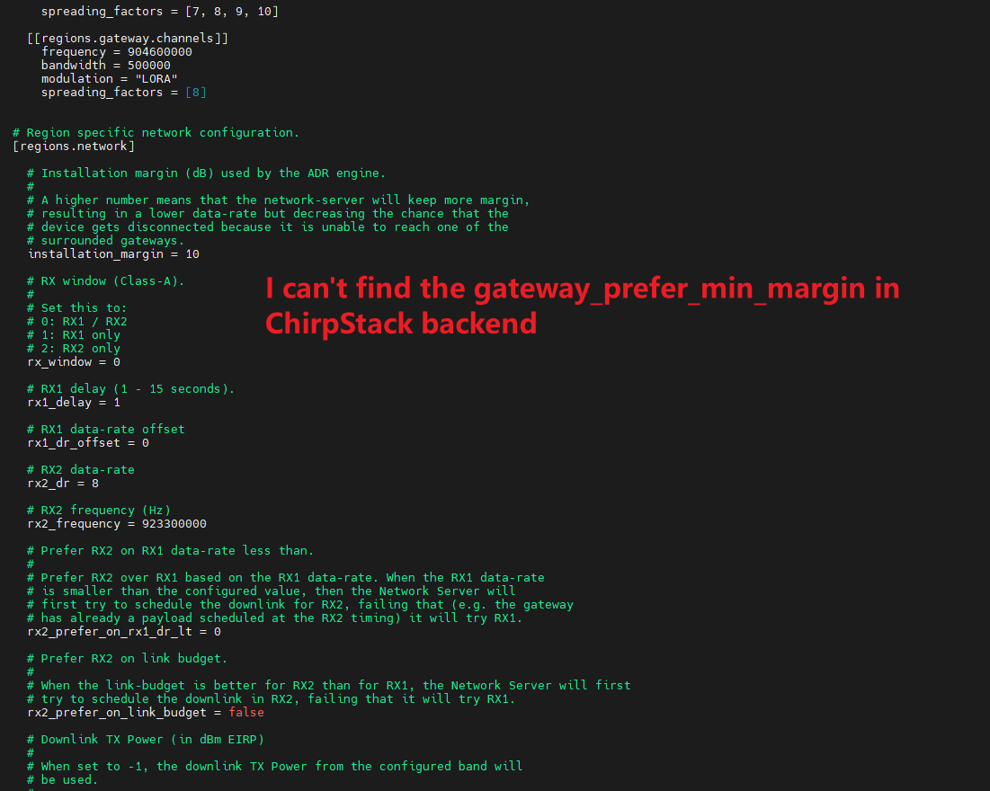

My chirpstack version is V4.11.0. In the settings of the Ubuntu background, I couldn't find the value of "gateway_prefer_min_margin". Instead, I only found "installation_margin = 10". Can I add the value of "gateway_prefer_min_margin" myself? I asked GPT about this, and he said that this "gateway_prefer_min_margin" value is a boolean value.image.png
You can configure the gateway_prefer_min_margin under the [regions.network] configuration in your region_XXXXX.toml file. If it isn't there, it means the default value will be used (10.0). You can override this default by adding it to the [regions.network] section.
This is false, the value is a float.
