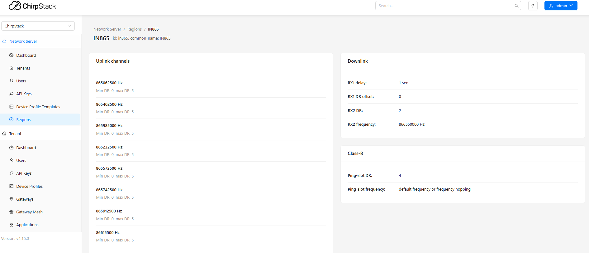

Additional Issue: IN865 Channel Not Receiving Uplinks
IN865 has 8 channels (screenshot attached).
But on frequency 866155000, I do not receive any uplinks in v4.
The exact same hardware setup (same node + gateway) does receive uplinks on this channel in ChirpStack v3.
