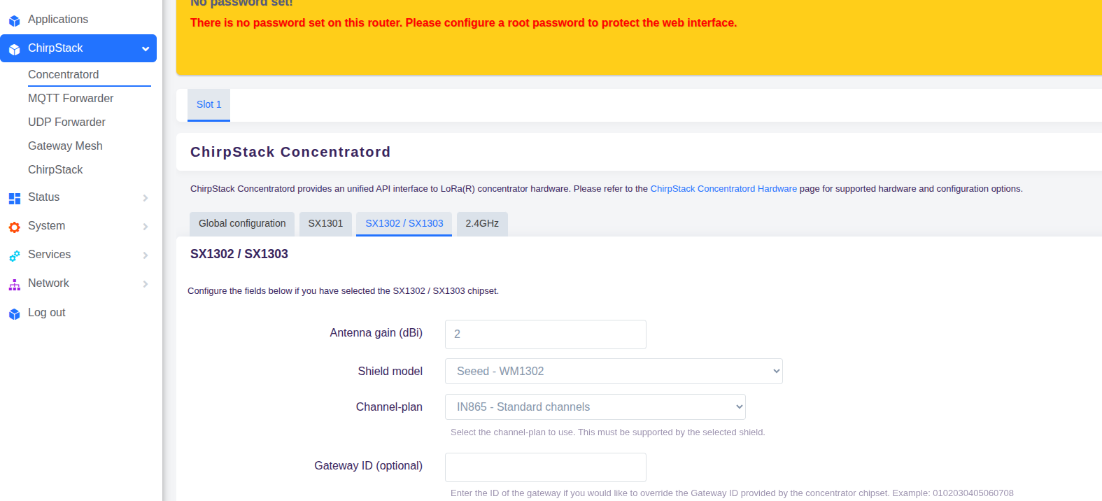

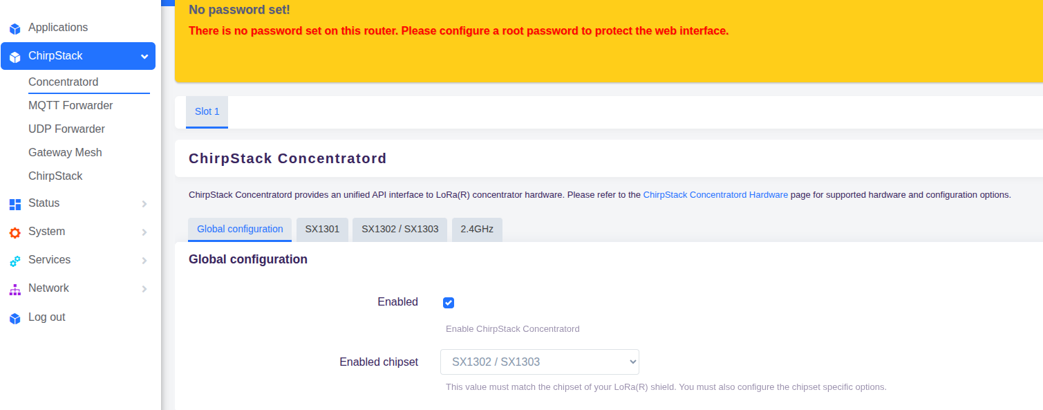

Here are the details of my Concentratord configuration from the UI:
Chipset: SX1302 / SX1303
Shield model: Seeed – WM1302
Channel-plan: IN865 – Standard channels
Antenna gain: 2 dBi
All settings are the same as what I used in the stock image where long-range works correctly.Screenshot from 2025-11-26 16-45-53.png

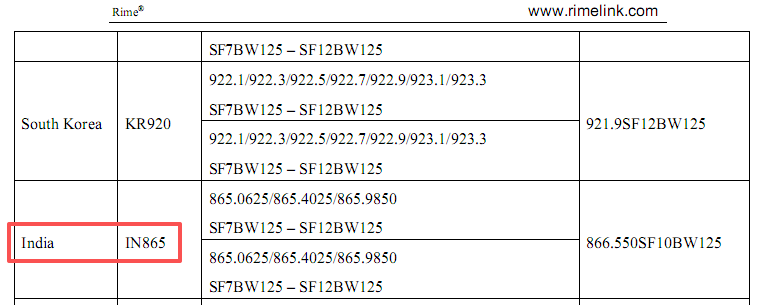

The three frequency points for IN865 are shown in the figure above, referenced from the 《Rime LoRa Technology White Paper》
http://www.rimelink.com/nd.jsp?fromColId=105&id=44#_np=105_315

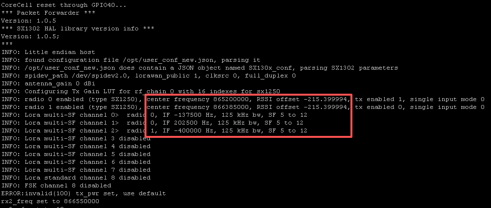

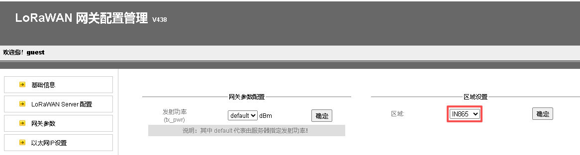

After modifying the gateway frequency band to IN865 via the web as shown in the figure above, the startup log shown below will display the SX130x center frequency and offset values.
